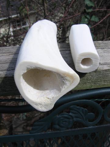

The local pet store never had any, but Sunday afternoon I was in Conway. The small one was $3, four inches. The larger, eight inches, was $4. I know Mario bandsaws his own. Then how do you get them flat? Just wondering.
I just hate finishing up a guitar and not having the perfect size saddle blank. Much of the time I end up at the Martin dealer buying a pre-formed plastic jobber. I prefer bone if at all possible. Pics in a few days of the results.

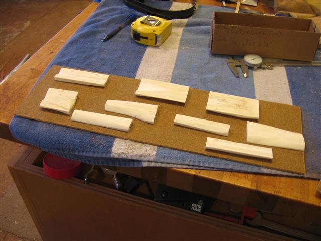

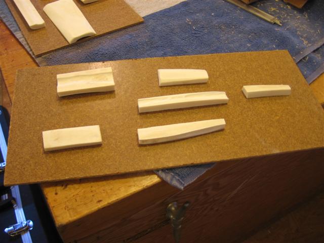

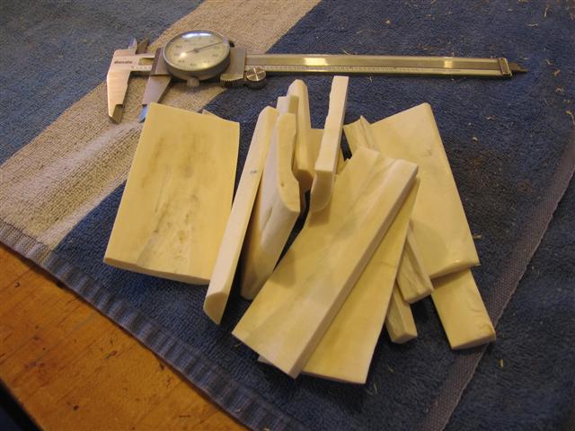

This is the sliced up bone, from the two pieces originally in this thread from PetSmart pet store.
The longer pieces will probably make saddles.

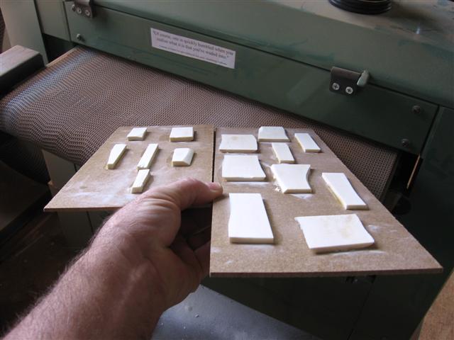

The short thicker pieces will make nuts. I have now hide glued these pieces to a carrier board. Tomorrow I will begin to sand these to thickness. Then toss the backer board in a five gallon bucket of water over night, which will remove them from the backer board.
The smell was tolerable with just a dust mask, I took it outside for sanding. I did get a little smell off the bandsaw but it wasn't that bad at all. I did shower before going out for dinner though!Bruce Dickey38794.002025463

I cut these carrier boards up on the bandsaw and dropped it all in a bucket for an hour or so. I now have the in a pan warming on the stove to remove all the hide glue so I can remount and sand the other side to final thickness. I'll probably save some this fuller size in case I need thicker material.
All in all, it's more work than I want to do. Buying bone blanks just makes good sense, like Steve K. says. But for that special size or application, it's nice to know that it can be done. I would like to try a hand plane on a piece to see what that is like.
